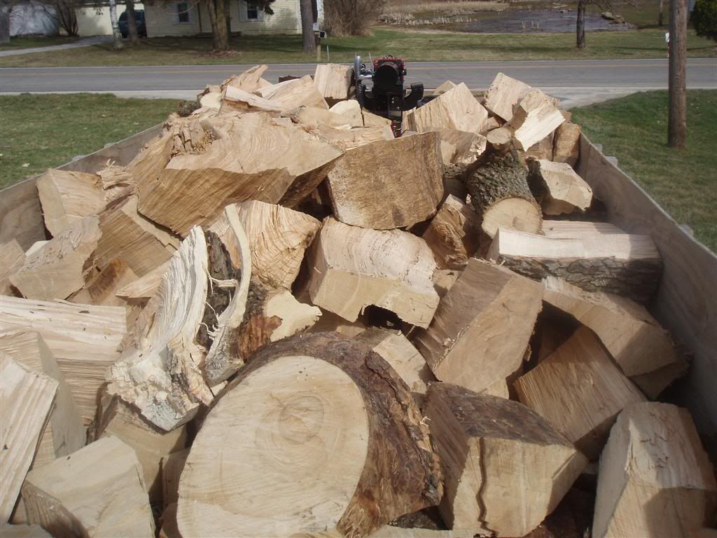

The plywood sides are two feet high. If its 16 x 6 with 2 foot high sides, that would be 192 cubic foot. This trailer looks like it was loaded almost double that (2 1/2 to 3 cords?)
Looking at where the wheel wells are to the top of the tires, that load had to have been way over the 7000GVW rating on this trailer.
How do you know if a trailer has been overloaded too often/too much, i.e., abused beyond the point its prudent to buy it? What should I look for that might make me decide to walk away?
(Or is this kind of load "normal" for folks burning wood?)
I'm supposed to pick up this trailer late tomorrow afternoon, and I'm traveling a fair distance to get it. I'll be using it with a 2007 Expedition, 9000 towing capacity, so towing capacity isn't an issue if I don't overload.
It's loose tossed wood, so it may not be overloaded. The trailer I use is similar, it's a car hauler that I use for my cars and put sides on it to haul wood. The sides are 16x2x7, loose tossed a little over the sides is about 1 1/4 cords. A dense fresh cut wood and you can overload it in a hurry.

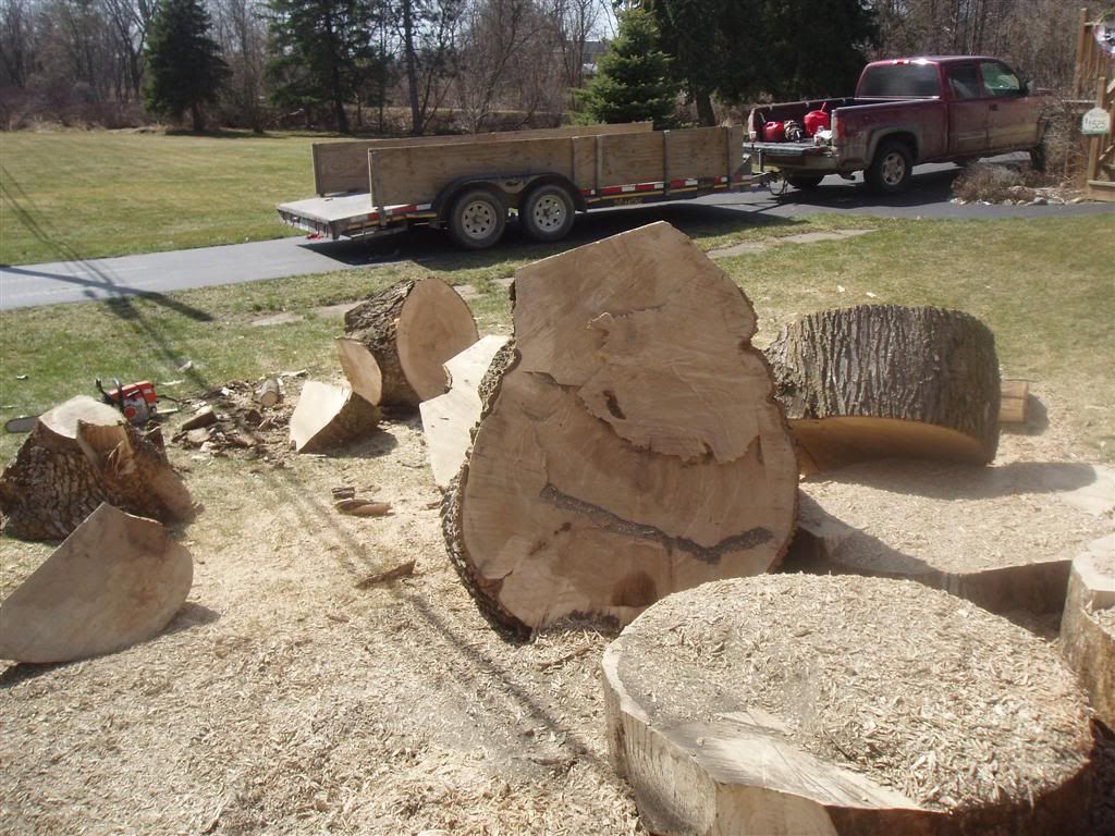

Here is what I use, best pictures I have handy right now.

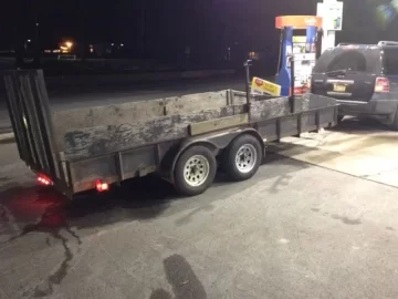

With your truck and wanting to haul wood, I'd get a 10K trailer. That said, that looks like a reasonable $1000 trailer. Check the tires and brakes as you could easily put another $500 in it pretty quick.

Look for abnormal where on the tires...and make sure it doesn't shimmy and shake or want to track funny when pulling. Take it out for a run and try to hold speeds for a 10-15 seconds in about 5 MPH intervals to check for a vibration. I borrow a trailer every once in a while that about shakes my teeth out at precisely 35MPH and 55MPH. That's about the best way to tell if the axle is junked...but that doesn't necessarily mean it isn't bent...just not bent bad enough to be a big deal.
For a G, I'd be seriously looking at it with cash in hand. A 12' single axle w/ ramp is worth 7-9 hundred depending on condition.
I'd be looking seriously. A fellow who I haul with uses a rig like that. Works well.
Lots of weight in the back of that Trailer.
Look at the shackles for weird wear.
It is probably a fine trailer. See if he has matching rims.

Easiest way is to look at how the wheels sit on the ground. Make sure the are a true 90* to the ground, If they are tipped in at the top it has been grossly overloaded. Those are only 3500# axles and are easy to bend. I would look for a trailer w/6000# axles it will have a 6 hole wheel instead of 5 on a 3500#.

The trailer is well used, but the mechanicals all appeared sound.
I bought it and just got it home at 8:00. The wheels and tires all sit straight/ true 90* to the ground, the tires are good (load-range D) and he included an extra two good tires in addition to the spare (but the spare needs replaced), the trailer tracked/trailered perfectly, and after a hundred miles when I stopped for gas the axles and hubs were cold to the touch. I had not planned on getting a 16' trailer, I had hoped to find a 10' or 12' tandem, but they were impossible to locate. I'm satisfied with this trailer. We'll see how it does with use.

I've owned several trailers. Check welds. Usually if something has been severely overloaded one of 2 things will occur. Either the deck/trailer frame itself will be bent or a weld will crack some place. If a spring has been broken and fixed its not that big of a deal. Also check the wheels to make sure they don't have any cracks.
Overrall that looks like a decent trailer from the pic. My dad bought the exact same trailer for $900 a year ago but it needed a new deck. $125 later he has a $1500 trailer in my opinion.
