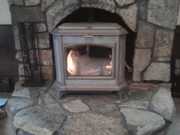

I just had the Progress Hybrid with the short legs installed yesterday. So far, so good, i'm just getting used to the stove. I have never owned one before. The Hearth that the stove sits on is made of irregular stone, and the whole hearth is slanted slightly from back to front. As a result, my stove is only sitting on 2 legs and barely resting on a third. One of them isn't touching at all. I emailed Woodstock yesterday asking if they could cut me 2-3 legs at custom sizes. They are going to send me some shims to try first... I don't think I am going to like the look of 3/4" of shims under the front two legs, but I guess I'll give it a shot

That's cool looking. Almost hobbit-like. I would shim the legs with small squares or disk of steel. Large flat washers would work.
Congrats! Nice looking install! My front legs don't sit flush and I've thought about putting some shims in there, just haven't gotten around to it yet.
Are you saying this is your first stove ever?
smitty79, that is a beautiful install. First stove, I predict you'll love it.
Very nice, smitty79, very nice indeed. That is a perfect setting for the Progress short leg.
Wow, two great looking installs.
I love the rustic look of both.
