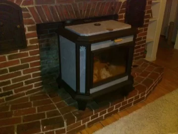

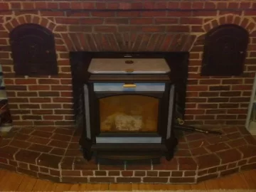

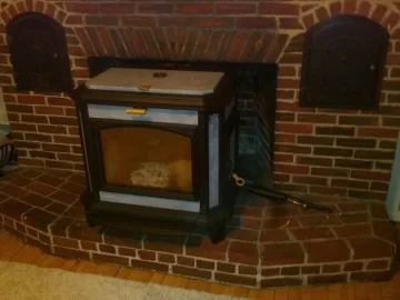

I had ordered my Progress with the plinth base, but due to delays, they offered me one with short legs after looking at my hearth. So I went to pick up my Progress last Friday. They said it has <del>the upgraded butterfly valve</del> and the new door gasket. I got home early afternoon and since help was not available until Saturday, I tried to at least get it in the house. I made it to the from the back of my truck to the front porch before I called it a night, about 15 feet :).
After help arrived on Saturday, we tried using an old dolly, but found it easier to just lay down 2x6's and slide the whole pallet into the house. After we got it inside, we got it all put together with the legs and heat shields. Then we lifted it from the pallet onto the hearth. The lintel of my fireplace is only 28.5" high, and luckily, the progress just fits. The lintel is actually touching the top of the stove. Since it had spent a night outside, I gave it the rest of the night to warm up to room temperature.
On Sunday, I did my 3 break in fires, which thanks to Dennis for his excellent directions, went without a hitch. The biggest fire I have done so far is the 3rd break in fire which only got to 400 degrees, which threw some serious heat. The stove is beautiful. It is nicer in person than seeing it in pictures. My wife likes it too, and she didn't like the look of the stone stoves before.

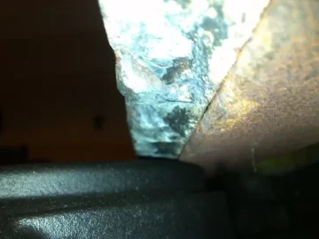

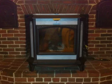

I'm sure I will have more to add later, but for now here are the pictures. The last picture is the lintel and the top of the stove.

Great Install, Nater! Looks really nice.
Do you have access to the cleanout T behind the stove? looks tight.

Looks great! Sweet stove.
Great looking stove and a beautiful hearth!

Very nice looking!
Congrats :-)
Thanks for the pictures Nater. Beautiful.

Thanks! I'm working on my first fire right now after the 3 break in fires yesterday. It is only 40 out so it is quite warm in here tonight. :) It is giving quite a light show too. Such a difference going from an old steel stove with no window to this one. When the progress is at 450, it gives off at least, if not more. heat than when the old stove would read at 700+.

Looks really good - do you need a hearth pad in front?

No, with the ashlip only 8" of clearance is needed and since the hearth is raised, I did not need one. It does however need slightly more ember protection around the door. I have something there temporary, but it is not in the pictures.
So, it's still 8" clearance with the short legs? Seems like it would be at least the 8" + 5" (lost leg height), but then again, maybe this is why I'm not an engineer and can't even play one on TV :lol:
