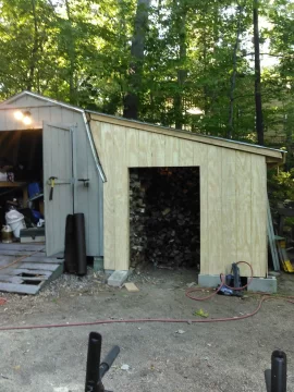

Got the sheathing done on the woodshed. Really looking forward to not having to knock snow and ice off the firewood. 8X16X7. We have 5.25 cord of 2&3 year wood inside, and 1/2 cord of chopped cedar for kindling.
Let it snow!
Might wanna get some sakrete and fill those empty blocks up. Eventually the weather will foster perfect conditions for them to fill with ice and break. Easier to fill them than replace them. Better footprint also.
If you get the sakrete already mixed with sand you can just pour it in dry if you want. Weather and ground moisture will do the rest.
