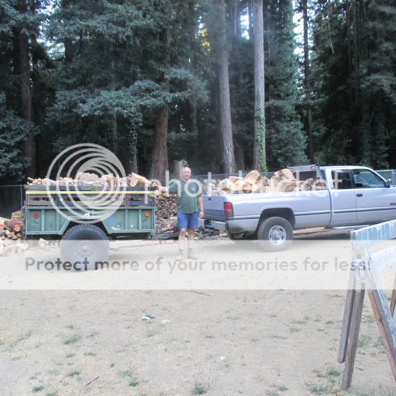

This is where I am so far:
![Woodshed Build Woodshed Build](/talk/proxy.php?image=http%3A%2F%2Fi88.photobucket.com%2Falbums%2Fk194%2FBob95065%2FWoodshed%2F100_1138_zpsb59e68c3.jpg&hash=c7d1b7364f2636044a4f77d07f8c0ce7)
I put 4x4 brackets in concrete piers that I poured a few weeks ago. This keeps the wood off the ground to prevent rot. I am impressed with how stable the pin connection is. I thought it would be wobbly but it isn't.
It looks flimsy now but when I put the second course of 2'4s up it will significantly increase vertical support. The shear wall in the front will help too. I'll post more pictures after I work on it this weekend.
