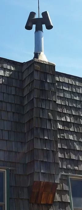

Heating 1800 sqft over 3 floors with a 2 cu ft stove will be a challenge. You should really go larger than that. Next to the 30NC you could also look at a large Drolet like the Myriad. The Drolet stoves have the advantage that they only need an ember-protection hearth while the 30NC requires a r-value of 1.5. N-S is usually considered more advantageous than E-W: More optimal use of the firebox, no splits rolling against glass or even out, less reaching into the firebox potentially leading to burned skin, etc.
How tall is that 8" flue? A stove which is designed for a 6" flue may work with an oversized one but don't be surprised if draft is not optimal.

Thanks for getting back to me. My existing stove sits on an elevated hearth and there is 3' of 8" flue before it takes a 90deg through the exterior wall and then another 90 up about 15' inside an enclosure that is part of my modified A-frame/Mansard roof.
