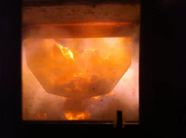

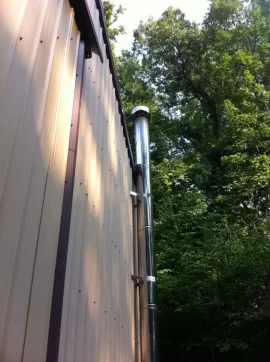

here is some pics all taken immediately after adding the first load. 5-10 minutes after striking match and this thing is off to the races!

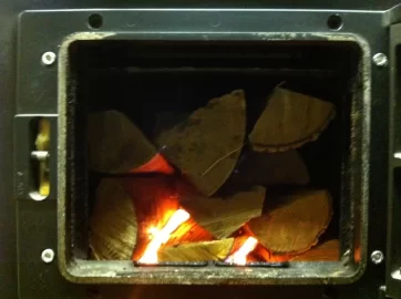

My helper and i just added two more sticks for a total of 105#s. that should be all i need. Tanks are at 172/154 and boiler at 195 so the rest of the water will cycle through quickly. Fire box is currently half full of all oak. Math time.
