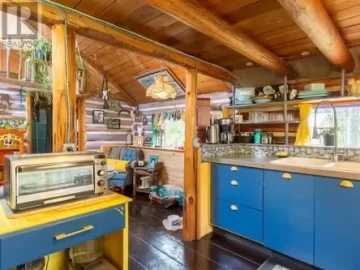

I have a 650 sq ft log cabin in Northern BC near Smithers. Elevation 520 metres/1706 metres. Temperatures can get to -40 degrees Celsius in winter. Cabin is open, with 2 lofts on either side of cabin. Small addition on back of bathroom and laundry behind one log wall. I was looking at Blaze King Sirocco 20.2 and Chinook 20.2 on recommendation from a local heating company that will be doing installation, but then spoke with a different company that said those would be too big. That I would not be getting the full benefit of the technology because I would have to have small fires. With supply and demand issues and living far north I am getting worried about this purchase. Can folks here recommend a good stove for this size cabin that will burn through night ? Wood stove in photos is not there anymore.
