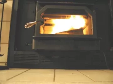

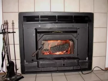

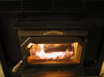

Country stoves has 2 models that are rated for zero clearence fireplaces, the c160 and the c210, I have the 160 in my zero clearence box. Looks like country has merged with Lennox Hearth Products, I went to County's web page and got re-directed to this one

Here are a couple pics of my insert
