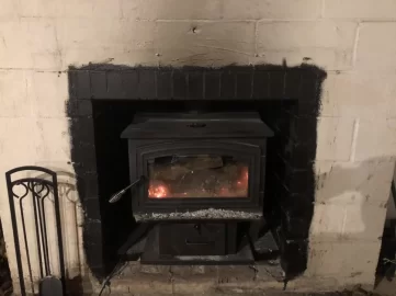

That’s our set up.

That’s our set up.
You are also limiting the heatoutput by stuffing it inside the firebox. Any radiant heat given off will be sucked up by that masonry. Do you have a fan on it?
Yep. There’s a pretty strong blower behind it forcing the hot air forward. Unfortunately, the way the chimneys are set up is very stupid. So the only option was to stick it in there.
Did you buy your stove from a stove shop, and if so did they suggest or approve the installation of the stove in a basement fireplace when the aim was to heat 4,000 feet of space? Or was this something you designed? Who installed the stove and what advice did you get about the installation?

Wait. How are you reading the temp again? That stove should be connected to a stainless liner, not double wall stove pipe. Where is the thermometer on the pipe? It looks like it's on the stove top in which case 600F is not too hot and you don't need a probe thermometer.
Just moved it there thanks to a suggestion from here.
Is there a block-off plate above the stove in the damper area?
Even when you get this thing running right, it is going to struggle because it is enclosed by a giant heat sink on 3 sides. Normally I'd advise you to go stove shopping for a rear vent stove, but in your case, you have a temporary need for a basement stove?
If you want a stove down there long term, my advice is to pick a rear venting model that can sit outside of the fireplace, and move the old one upstairs to go on your new hearth, if it is still in good condition. You could get the new basement stove before the remodel so the basement is warmer, and build it a cheap temporary insulated hearth pad to live on in front of the fireplace.
Any basement stove will benefit greatly from floor and wall insulation. If it's heating masonry that is in contact with the earth, that heat is just gone.
In the short term, can you get some pictures of the flue pipe where it connects to the stove and where it goes up the old chimney? I think we have some confusion as to what is going on there. Photos will let us ID the venting system.
Is the inside of the fireplace insulated?
