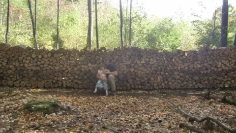

That stack behind me and my girl is bark up.
What a nice stack of wood. Oh, and daughter too. I have always put the bark up as well.
