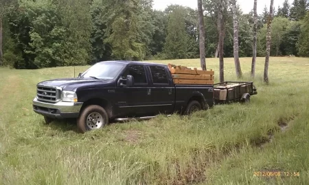

Yep. I have a short bed which is 7 feet long on a full sized ford. I load it to the top of the racks which is exactly one cord per my calculations. I built the racks for one cord.
Here I am this last friday sunk to the axle in mud. I needed a tow truck to pull me 10 feet onto the road.

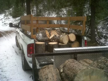

I have uploaded ( or at least attempted to) a picture of the racks i built for my 2004 Dodge 2500(Cummins). They work great for adding capacity and protecting the rear window. They had to be customized a little further than normal to allow for the tool box I keep in the back as well. I hope this helps.
I have uploaded ( or at least attempted to) a picture of the racks i built for my 2004 Dodge 2500(Cummins). They work great for adding capacity and protecting the rear window. They had to be customized a little further than normal to allow for the tool box IView attachment 68677 keep in the back as well. I hope this helps.
that is a sweet setup.
I have a buddy that has an 05 Dodge. You have to make that thing squat.
He has a slide in camper that doesn't even bother it. Loaded up and ready to go.
