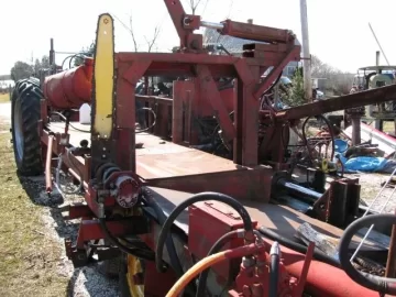

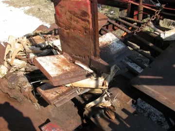

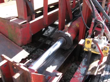

Just cobble one together like this one made several years ago cost $800 gathered parts ,4cly diesel,pump,valves begged borrowed from whatever wherever,looked at others and built this. I have split 100's of cords it will cut 30" and split 6 ways works well

I'd like to build one, just to build it. But I think that I have gotten to anal about my split size to leave it up to the randomness of a 4 way wedge & gravity. Besides, my splitter (that I built about 33 years ago) & I have a good long term, trusting relationship that I will not disrespect just for a cheap fling with some flashy, new & young and shiney bimbo split.....er!;lol
Whitepine - how about we see a video post of that bad boy in action !!! I too would like to build one just for the fun of building it and welding experience. I know the economics might not work out, but then again they didn't for my splitter and I couldnt be happier with that.
Ditto!!
I have seen this one in action in person. Runs around $10K. And of course you cannot find one used.
