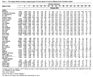

The cheap moisture meters aren't accurate. They don't know what species of log they're stuck into.
The MM measures resistance but displays it in % moisture. On the attached page from the Forestry service,
The column under 20% moisture for sugar maple is 2.24 megohms and for elm is .48 megohms. That's
a big difference. If you can't tell the MM what species it is measuring, it can't apply a multiplier to arrive at
an accurate reading. Might as well hold a fresh split surface against your cheek or judge by its weight.

Well, that's $30 I'll never get back.
I suppose I can back-engineer it; Figure out what percentage each species reads when it's dry, in a trial by fire. Of course, by the time I get done handling and burning all that wood, I'll know weather it's ready just by feel.
I bought the thing thinking it would help me get through 'til Spring on the dead stuff I'm finding. So much for that theory. Oh, well, maybe my roof will start leaking and I can use it to find the wet spot...
