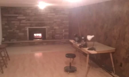

Yes, Adkheat I was very happy with the 1402 (recently sold the house). It heated my basement awesome. This was my first stove, picked it up used on CL and installed it myself with a full length liner. I have to admit, this site was key for help and questions. Some parts like the trim where missing so I made my own. The stove takes a bit to get up to temp but after you get it cruising its awesome, heats like crazy. All the brick around my set up really held the heat. You will be happy with ours. Here is a picture of my fireplace as I was remodeling my basement. I used to like to sharpen a chain or two while adjusting the stove with the next full load.

Yes, Adkheat I was very happy with the 1402 (recently sold the house). It heated my basement awesome. This was my first stove, picked it up used on CL and installed it myself with a full length liner. I have to admit, this site was key for help and questions. Some parts like the trim where missing so I made my own. The stove takes a bit to get up to temp but after you get it cruising its awesome, heats like crazy. All the brick around my set up really held the heat. You will be happy with ours. Here is a picture of my fireplace as I was remodeling my basement. I used to like to sharpen a chain or two while adjusting the stove with the next full load...View attachment 156147
