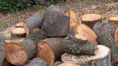

My tree guy dropped off this wood. Is this cherry? How long will it take to season?

cherry
I'd say most of it is cherry, but one large round standing on end appears to be Red Maple. both should season pretty fast.
Some folks say cherry will season in as little as 6-9 months . . . and maybe it will . . . but in burning cherry, ash, elm, maple and what have you I can say that in my experience even the "fast-seasoning" trees burn a heckuva lot better given a year+ of seasoning . . . night and day difference in how fast the wood ignites, moisture left in the wood and how fast and intense the secondary burns occur.
That's not cherry, that's popple-pine, a dangerous wood to burn in any wood stove. I'll PM you about my free wood removal service so you can rid yourself of this hazard. ;-)

As far as the OP's nice load of cherry (and that big red maple round), cherry is not a particularly fast drying wood. It is often (but not always) fairly low in moisture content when first cut, and I think that's why it has the reputation for being quick drying. Still, 6-9 months is plenty time to get it down close to 20%.

Jake and I agree again! But yes, cherry can burn after 6-9 months of seasoning if it is split and stacked in the wind. At deer camp we used to just go out and cut some cherry and burn it right away. One had to keep a pretty good fire going all the time to keep it burning so used a lot of extra wood but it worked. But then, deer camp doesn't last that long either so we got along just fine. Most folks had enough alcohol in them they didn't need extra heat but some of us enjoyed it.

Good eye, Duck.
Will it burn in 6 mo. - yes. Would Jags burn it in 6 mo. - No.
