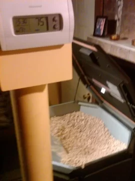

I'm not sure how the thermo connections are on the Astoria but I just installed a Honeywell FocusPro 6000. It is a wireless programmable thermostat. It does require 24v to power the remote box. Your stove may or may not put out 24v. Mine does not but it is easily fixable with a 24v transmitter for a home security system ($8).
top one is my pellet thermo
