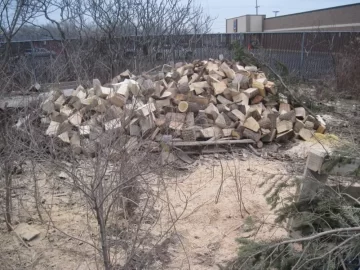

Here's my pile of winter cut wood. I cut them small and try to create as many cut sides as possible. The smaller logs that were branches with only 2 sides cut will propably be left in that pile to season at least another year. I have burned some of this in my stove. It is ok to burn especially when the air control is left open a little till I have a decent coal bed. Small pieces sweat quickly in a hot stove. It hasn't been cold enough where I care about having top heat output. Alot of these logs were cheap or free, so I'm not too picky with it. There's very little good stuff in there, but it heats ok and the price was right. I'm gambling that the stuff exposed to the air will dry a little, in the winter air, before getting burned. I know it's not stacked correctly, but I was more concerned in getting the logs off the ground before they rotted in the short time I created this pile. The wood had a little better chance of not rotting if cut-up and mounded especially with most of this being burned if we ever have a winter.
MM a new splt and burn what you can.. Maybe have to feed some small splits to keep up a good fire, but doable.. Watch your creo build up in your stack.
I also mix that with this pile which burns alot hotter. This is better seasoned, mostly good hardwood. I'm not too worried about creosote.
