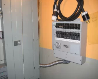

I have a Generac 7500 Generator and a Transfer switch hooked into my panel box to run at least 10 circuits[including the outlet] with the pellet stove plugged in.
that said, in a power failure, I won't chance running the pellet stove. 50% here say it's ok==c... 50% say shouldn't run on dirty power..!!!
I run my oil furnace until power is restored...saved enough on oil so why chance it..;lol
