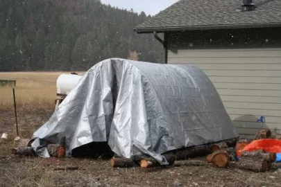

Just built a tarp shed yesterday for the shop wood pile. The snow
gets very deep here and just covering with a tarp makes a igloo shaped
pile..that you have to dig down to get out the wood.
The shed is made of 3 cattle panels of 4'x16' I bowed, then fence stapled them
between two 6" x 12' logs. Fir sapling ribs were lashed with bale twine inside each end and at
where the panels join. Bale twine and staples hold down the tarp. About
$100 for the panels and tarp. I used the heavy silver hay tarp and it will
last for quite a few years. This one will hold 4+ cord easy.
White Trash? ---- MM
