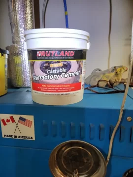

I bought a bag of refractory a number of years ago from a company.The company specialized in products to do with high heat applications.
I went with their recommendation of what refractory to get.I also got a bag of stainless steel needles to add in for strength to keep it from cracking.

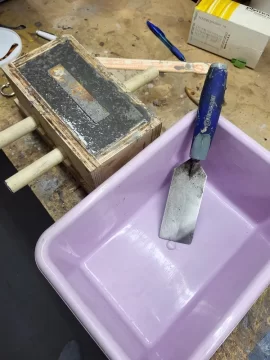

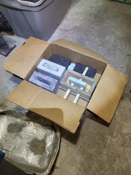

When I went to buy a new nozzle for my econoburn 100 last season and went on their website , i was shocked to see the price at $180, Yikes!. Time to make my own. Heres a couple of pics . Haven't had to install one of my homemade nozzles yet so i can't vouch for their durability , but i suspect they will be fine. Salecker I like your idea of adding those needles to the mix . Bruce
