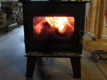

Howdy AM. So for the past 2 evenings I've loaded the stove in this manner. First I start off with about 6 really small splits that I get rip roaring in the bottom of the Austral with the help of generous amounts of kindling, and after they've burnt like that for about 15 or 20 minutes I load my regular load of 3 large splits and 3 medium splits all on top of the burning splits. The wood is all approx 16-18% moisture content, and it takes off like a bat outta hades. I have the air completely shut down, 100% shut down, within 5 minutes, and the blower on full speed to keep the stove top cool; ~720-740F right at the front where the flame and hot gas gets pulled up over the baffle, mid 600's back towards the flue exit. The whole firebox is 100% secondary fire on top, and no flames at all on the bottom of the load. The bottom half of the glass turns black within 15 minutes, but as the burn progress and the wood gets burned down, the glass is burned clean....
I should have mentioned, when I used the above method it was a cold start from a cold stove....
Just an observation of something I've been trying....

Thanks, Chuck, for the photo of your wood stove. Very interesting how you are starting your fire. I take it you have a wood moisture meter? I like that "bat outta hades" phrase for how quicker the wood begins to burn. This coming week I'm expecting all of the stove "stuff" to arrive. My worker will attach the OAK and he's going to trim the 3 maple trees in the backyard. I'll be cutting them into smaller pieces; some for kindling and the rest will be put away for use probably next year. I may as well take good advantage of the wood since I have been wanting to have the 40 foot tall trees trimmed for awhile now. The leaves are gone and this is the best time to do it, weather permitting, naturally.
Yes this stove, with very little firebox insulation, likes a hot fire box to kick things in gear like you described above. The reason for the glass coating is you said you shut the input air all the way. That input air is your air wash and with no air wash your glass doesnt stay clean but like you say as the heat goes up it burns it off. The rating on these stoves is like 5.7 grams emisisons , still meets emissions which the epa requiremment is something like 7 or below. But the thing radiates heat like crazy with less of a insulated firebox. Plus the stove has alot of control so a person can load it up on a very hot coal bed and some already burning small pieces. As if the stove gets going to fast you can control it. My old stove did not have that ability.
