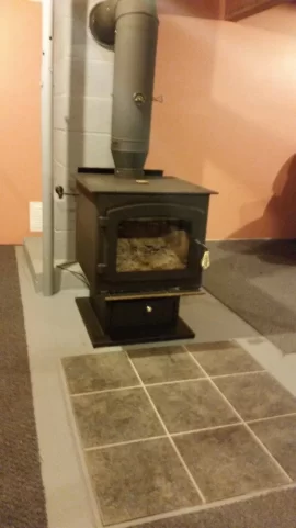

Here is a picture my Drolet Myriad Wood Stove made by SBI stoves of Canada.
SBI might be the largest wood stove company in t he world.
When I bought it from my Local Menards store for $300 off I was amazed at how heavy duty it was and the build quality for a $689 stove.
The thing radiates heat extremely well and the air wash that keeps the glass cleans works imho very well.
Here is a picture: I put the new tile pad in this past summer.
