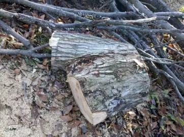

When I get them like that I stand it on end and split off the outside half of each trunk, from the top, with a maul or wedge. Then I whittle it down with the maul until what is left will fit in the stove. I usually get somewhere between 60% & 75% into clean splits. If I can't get it small enough for the stove then the remains end up on the uglie pile. I don't like to noodle it with the saw since the croch is usually full of dirt & grit that ruins my chain.
KaptJaq
Dont go past the middle though,fibers are too tough to separate without hydraulics.
I do exactly as KptJaq does, split it from the outsides in till the middle left will fit in my stove (I don't have to go far cause my door is 11x13"). Save the wear on your saw & chain, split it down.
Well that was certainly a poor cut when they cut the tree. If you have hydraulics then I'd split it right down the crotch then resplit each side. Easily done with the hydraulics.

So, I should have cut one "leg" off flush with the rest of the trunk ???
45 seconds? Want to buy a good chainsaw?If its most anything but Elm,a good strong hit from the maul about in the middle of each center usually does the trick,Dont go past the middle though,fibers are too tough to separate without hydraulics.But if it IS Elm or something else extra tough -Just like it sits there,right down the middle.Good sharp chain I could be through that in less than 45 seconds.
