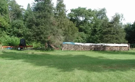

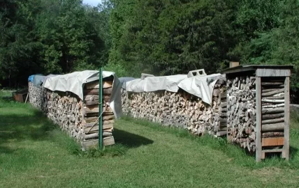

At the same time, cut and stack your wood for next year. I stack mine in an open area in east/west rows 8 feet apart, and put narrow tarps on the top to keep rain out of the center. The east/west orientation means that the sun shines on the south side of the pile, and the spacing keeps one row from shading the next and allows plenty of air circulation. If you can do something along these lines, wood cut this fall will be pretty good by next year. Ideally, you'd like to be two years ahead, but one year works if you can ensure good drying conditions.
