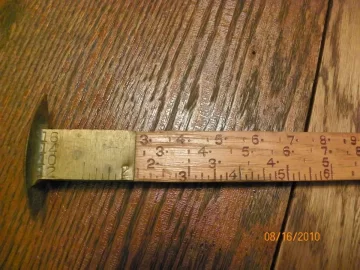

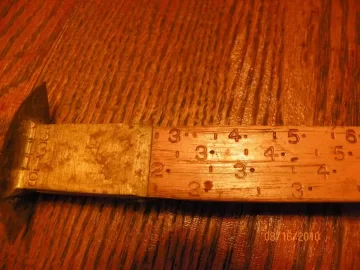

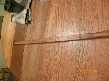

This was given to me by the man who sold us the land, was just wondering the correct name and how to use it. It is for measuring the diameter of a standing tree.

Is that different then a biltmore stick?
zap
zap
I don't know. I think it is used for calculating how much lumber you will get out of a tree. There are a few of those kinds of sticks in the lumber industry, each with its own kind of scale for the purpose.

zapny said:
http://www.clemson.edu/extfor/pest_management/forlf15.htm
Just found this.
zap
That works you can tape that to a clip board and have your bf in just a min.
Zap, the only time I've ever seen a stick like that actually used was by a local woman who took over her husband's hardwood business after he died. She knew nothing at first, but quickly became the most knowledgeable hardwood specialist in our area. She used her stick to calculate board footage in lumber that was already cut. She was fast, and she always got it as close as you'd get using a tape and a calculator.
I did several different searches on the Internet because the markings in your stick don't look like any of the scales I've seen on the various tree scaling sticks. Finally, I think I have the answer. You appear to have what's called a "tally stick", and it is used exactly how the woman I mentioned used hers - to tally the amount of board feet in lumber that's already been milled.
Here is a link to an article about them. On page 18 of the PDF there are closeups of the markings on the stick, and they correspond to the numbers on yours. There are also detailed instructions on how to use it. So now when you bring home that Hud-Son mill, you will be able to figure out the board footage the old fashioned way. ;-)
http://schools.u-46.org/public/03_Measuring_Unit.pdf

Thanks Battenkiller but my PDF software won't update so until I get new software I can't read it. I hope Saturday is a nice day in Boonville, it should be packed with vendors.
