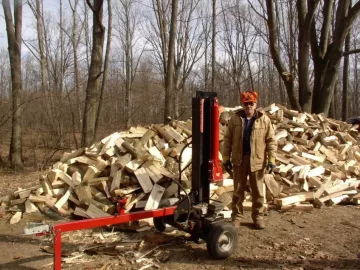

  • [Hearth.com] What is the biggest round you've ever split.

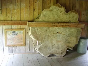

Check out this monster elm that I discovered in Tennessee. It's over 6 feet in diameter IIRC. The placard claimed it was the biggest elm in the U.S.A. (or was it North America... or was it THE WORLD!?).
Warning: May cause nightmares in those who split by hand!

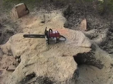

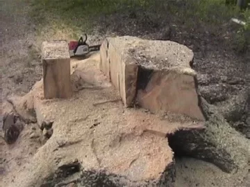

How's this one:
Maybe not "trully' splitting...a cross between splitting and carving. This pine stump was over five feet across (the 'splay' at ground level even wider). I do stump grinding...and my 'reputation' got me this job. The homeowner wanted the stump gone...but didn't want his lawn damaged by huge equipment (again...as big as the tree was it 'took some doing' to get it out with minimal damage). My machine will grind good sized stumps...but not if they are too high...so I had to 'cut it down a bit' (not to mention reduce the amount of chip) While the competition has 'bigger and better' equipment that could have made short order of this stump...I provided the level of service the homeowner wanted...and he paid accordingly...one of the best stump jobs I ever did too.
I would say "honorable mention" to the fact "tree guys" saw "high above the ground" to avoid the 'dirt splash' of the lower portion (which quickly dulls a chain)...cutting something this big...low to the ground isn't easy on a chain...
The 'splits' are 18" tall...the saw is a Stihl 036 with (I believe at the time) a 22" bar and chain.
