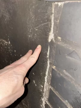

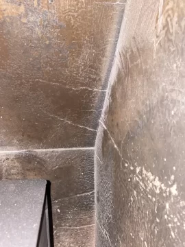

yeah! I was thinking that I might as well do that while I'm in there. My fireplace has what looks like cement board already in place, or possible it's part of a cement form? I think it's original (1973) because it is flush with the sides/top of firebox like it was supposed to be there.Next you will want to insulate that fireplace, it has been proven to help keep the heat in the insert and blown out via the fans, not out to the masonry and warm the outside.
