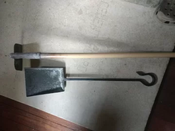

So, in almost 40 years of burning, I've come up with this:. I start with no ash during the first load. Then I let it build up until it starts to take up too much space in the stove. If I have enough space in the ash bucket, I take it all out and start over. If the ash bucket fills up before all the ash is out, that's how much I leave. Somehow it seems to work out perfectly.
