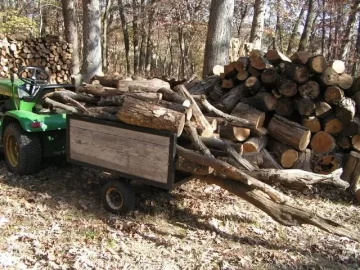

CTYank said:
No way am I going to cut "skinny logs" to length in the woods. I cut them down to 6-7 feet so they fit on the p/u, and haul them home.
At home, cheapie HF 10" table saw cuts them to length really quickly, turning min amount of wood into dust/chips. Effective buzz-saw for small stuff.
Chainsawing small stuff can get a bit "sporty."
I hear ya. Anything that's 2" -5" and worth bringing in I just leave them 3' to 7' lengths,haul them in cart or p/u & cut them on 20 yr old Delta miter saw (my old one for rough work) Quit cutting small stuff to length with the chainsaw in the field years ago.So much better for my back.I use a 6 ft rip of scrap 3/4 plyform as a table,either spanning the empty cart or a pair of metal sawhorses.Miter saw is only 1/8" kerf,its way faster than chainsaw with less work.

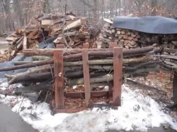

I cut my logs into multiple log lengths for transport - saves cutting in the field. I save two or so good size lengths that are 8" or so in dia. Place them side by each on the ground to form a cradle of sorts, Throw a third length in the V formed by the two logs. Brace with foot and cut into 18" logs. Kick or toss logs/rounds out of way, place another length into cradle, rinse and repeat until pile is done. Cut up cradle logs at the end by tossing them onto the pile of cuts and brace with foot while cutting. Bucking is back breaking work but this seems to get it done for me with a minimum amount of diddling around.
