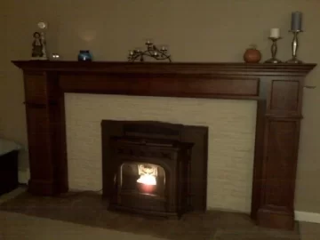

		 , I'll be using a 12V gel battery with an inverter from Walmart/BJs for my backup.  That's about $100-$150.
