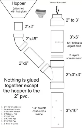

Here are two pictures of my pellet vacuum. Design found in the pellet mill and I adjusted it to fit my needs.
I will try to post another picture of it mounted. It is worth it to build this design as it is fast and simple.

Bill
PS. I want to add a dedicated vacuum to the system, mounted above and wired to flip a switch next to the pellet vac.

Yowza...nice!

Yes, the wife is quite happy that the dust has been reduced drastically.
Bill
