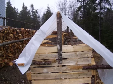

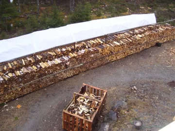

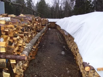

I "tent cover" using 6 mil plastic sheeting attached to a frame made out of small diameter spruce. Breathing room underneath, solar warming effect, dry all the time, and the runoff doesn't run down the side of the stack. The cross members of the frame that go through the stack really help stabilize the double row, the weight of the stack on the cross member as well as the weight of the outside rails help hold down the tent, which so far haven't budged to 60mph winds. In bright sun it gets pretty hot under there, this weekend it was 45 degrees outside and I got 80 degrees on the top split of the stack with my laser thermometer. The first picture shows the back stack covered and the front stack with just the frame awaiting the covering. Stacks are N/S double row 18" splits on pallets 4-5 feet high and 65 feet long, about 6 feet between stacks, would have liked more space between stacks, but that is all the space I had, maybe 7 cords in each stack. Back stack is all spruce, front stack is mixed hardwood, a lot of birch and red maple. All bucked and split by hand. I would like to add a few vents along the top rail, maybe just a slit in the plastic every few feet, but I am worried that will make it easier for the plastic to rip. I also have two other single row stacks on spruce logs instead of pallets, maybe another 1.5 cords, covered the same way, they are not nearly as stable, due to being single row. I had one go over in wind, which when it is one continuous frame for the stack, it takes the whole stack over, that got re-stacked double row on pallets. I had a stack go over on top of a family dog when I was a kid, so I am kind of sensitive to the stack being stable as possible. Uglies bin in front, a great idea I got from this site, I used to just throw them in between the stacks, but for more ventilation decided to make a bin.

That is impressive!
Dave G, thats is pretty cool, I get some great ideas from this site

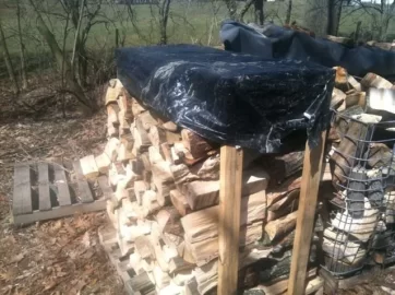

Here's my new method, I still have some stacks left from last year that aren't on pallets. Those are covered with rubber roofing (see background) and my new method covering with lumber covers. They're nice being 5' wide, I just cut a 3' piece and stapled it on.
