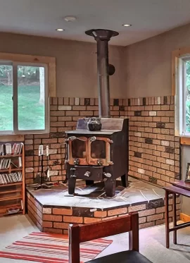

Hello all...
I'm buying a house with this wood burning stove in it. The inspector tells me it's an Old Mill brand, but doesn't know the model, there's no tag on it.The home seller doesn't have any information so. I'm stuck. The inspector says that with out a model humber to check the clearances to the wall, it's then it's supposed to have 36" of clearance and no one seems to know if the masonry wallboard thing is good enough too. Inspector says it would be simpler to replace the stove with something that requires less clearance than worry about the current set up.
1.) What Old Mill stove is this?
2.) Does this look like a problem waiting to happen?
Thanks again!
