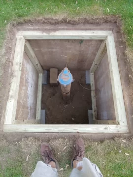

Here it is. 5x5x5 I ripped the majority of the framing out.

I'm not a carpenter, but a little dubious of the construction. The middle stringers don't look very strong with no ledger underneath them. Hope rustproof screws were used. Why were the top boards placed in parallel with the middle braces instead of at right angles?
Reactions: bholler
The middle stringers are 4 by 4's and are so tight I needed a dead blow hammer for one and a sledge for the other to fit them in.- I could easily jump up and down on them individually and I'm 185 lbs. They are also screwed in with high quality rust proof 4" framing screws.
The top boards are at a right angle to the frame, look closer.
Yes, to the outside frame, but not to the two middle braces. At least that is what it looks like if all the shots are from the same location.
Yes they are. The shots are not alll from one location, look at the well head.
Ah, that explains it. I wasn't sure if the cap was rotated. Makes sense now.
What are you putting on top of the plastic?
No offense, but I wouldn't try to keep a lawn tractor from falling into a hole with a few pieces of #9 steel wire, and that's what is going on with those middle two 4x4s held up with wood screws.
That center board has no support in the middle except the crossmember 4x4s, and they can only take as much weight as the fasteners you used on them can take.
If that is really assembled with wood screws, it's gonna be pretty dangerous when you cover it up. More so as time goes on, too.
At least it's not a long way down!
You're not reading what I wrote. They are framing screws designed for construction. You pose the idea of me falling into the pit because of a middle board failing? That would be a squeeze for sure.
A framing screw is typically #8-#10 steel wire with some threads cut into it. It doesn't have a different shear strength because someone wrote "construction" on the box. If you secured those 4x4 with screws and they're not otherwise supported, those screws are holding 100% of the weight that's on 'em.
So most of the boards have cement and 4x4 underneath the ends, and the strength of the board itself will hopefully keep it from buckling for some years.
The middle board is cut and all the weight is on those little screws.
I personally wouldn't have a problem walking over it, but I wouldn't drive any machinery over it.
That's not entirely true. The center supports were smashed in with a dead blow hammer and a sledge. So they also have strength of how tightly I fit them in.
Say what you want about the gauge/type of screws I've used, I could drive my lawn tractor over this all day long without a problem for years. I'd be willing to bet that I will have to have my well pump serviced long before these boards failed, which at that point I can check the framing again.
Sure I could have poured concrete footers for all the framing including the middle boards, but in my opinion it would have been excessive and time-consuming.
