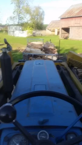

It’s a shibaura. And yes I think It’s a toss up between the bucket and forks.
That feeling when you realize that there is someone else nearby who is also using a blue tractor to huck around IBC totes of firewood with the end goal of feeding a Blaze King.
I think there must be something in the water.
