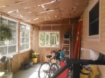

After hours of searching/reading I'm considering getting a Castle Serenity. Seems all the more affordable/available and close by ones seem to be the England brand. I checked reviews and they seem to be more problems/cleaning issues than other stoves.The well known expensive brands are still expensive used.I know you usually get what you pay for. I found a working Thiel parlor stove(2006) for $500 with piping. I'm waiting on pix from the guy. A guy has a Big E used is wanting $800. Right now all within 4 miles Tractor supply($799), Ace($799) and HD($999). TSC has a neighbor discount and invited me to their store card which has 12 mo no interest option. Couple seconds later a retired old man is approved for $4500. Waiting for a tempting % off email for first order.
As for the Serenity it is pretty compact. I would like to center it under that window. The manual shows a straight out vent it would be setting above river pebbles that cover the concrete overflow. in would vent in a sheltered SW corner. If I outside air vent I an get an 18" distance to the window it is a well sealed double pane slider. The porch heats up nice after 9 AM so I'm hoping the thermostat option would help with of that. Thanks for any help and/or suggestions from owners.

Good choice on a Serenity, just to make you aware though in case you don't know the Serenity on thermostat mode does not shut down it just drops to low when set temp. Is reached. Once you have the stove up and running get a few bags of pellets from each store and see what burns best for you. On low the Serenity will burn about a half bag in 10 hrs.
