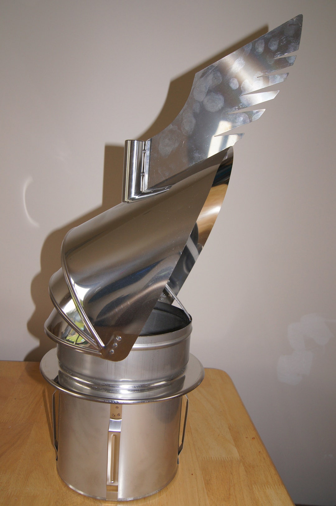

A neighbor has a rooster tail cap for this reason. It turns its back to the wind. They come in galvanized or stainless.
Thats the famco make sure you get the collar and ss model...You need loctite copper Lb 8008 grease for that and it's not cheap.
There is another cap that has a round shield that makes a space between the shield and standard cap but doesnt turn. I'm looking for a photo now..
Some had luck with that....
Here is the one on esty but it takes 3 weeks or so to ship overseas.
Keep testing...
Here is the one I have not tried yet..
So I tested the dragon cap compared to famco.
The dragon move much better and increases draft more (not sure too much yet).
Seems like it also drafts better at coaling stage and when stove is off. The needle on magnehilic actually moves or gets a good draft readings when wind is blowing outside.
The famco didn't do this because it binds up with soot or heat after a while.
To be fair this is only a week or so of testing.
