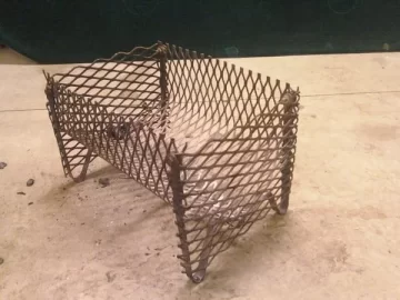

yes i did get gasification. actually quite good. I did get my camera to work. i think i attached it to this post. if nothing is there then i need to get more help from someone more computer savy.
  • Was bored and tried something of interest
Thanks. Keep us posted. It will ber interesting on how the basket holds up. You might have to use some stainless on the bottem to make it last longer as I've melted nails some what in my eko.
leaddog
that looks great. I'm getting turned on by the idea and want to try it myself. Is that metal lath you used ?

I bought the grating new at a local salvage yard that sells steel also. 4x8 sheet was $75. I used most of it to build cooking grate for a hog roaster. I used what was left over to build the basket. I am sure the larger briquettes would work better than pellets with the larger size and I think youu are correct I think as you say laying a piece of metal grating or installing a grate of sorts would work and allow you to really load up the boiler. I have found quite a few briquette presses on line but they are quite expensive.

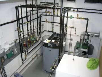

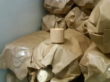

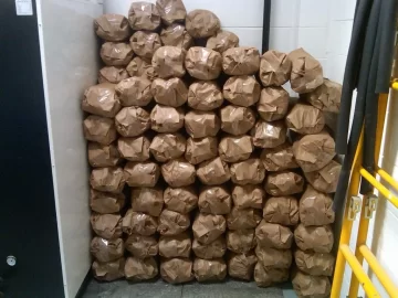

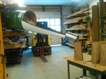

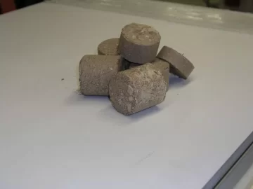

I have been making the pucks (all hardwood) since May last year and burning the Pucks this winter and have found they burn very well and very hot but do not last long. Six 10lb bags burn about three hours. They are very convenient but I think I may run out before winter ends so I am thinking of mixing some cord wood to get a little longer burn. The briquets burn so hot it make it hard to control the secodary air. This is my first year with heating a wood boiler. Lot to learn.
Attached are some pictures of the briquets and baging. I wanted to post a picture of them burning but didn't have the camera at work
Thats the nicest boiler room I've ever seen Briquetmaker! Very impressive. I might try one of the small pellet mills just to use the sawdust for something useful.It looks like you have your system set up nice.Get back to work tomorrow and make some more sawdust!
