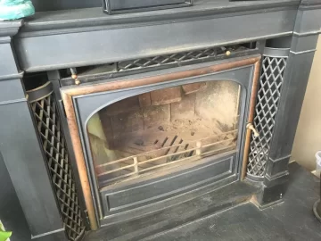

We have a VC WW that has issues. Our local VC dealer told me our flue will only accept the exact unit we have. No other unit. Thought we ought to ask for advice. Attached is a photo of our unit. Any/all thoughts and advice are welcome, please.
Thanks,
MK

It's a complicated old insert. It seems unlikely that the flue would only work with this insert. Did the dealer provide more specifics?
No, only that the flue would only accommodate the unit/model that we have and none other. No other brand or model. He stated our only option was to repair what we have. Just didn’t sit right with me.
Is the chimney and roof accessible so that you could take a shot of the top of the chimney? If not, it may be worth having a sweep come out and measure the liner at the top and take a picture or two for you.
We plan on a new liner when we replace the VCWW but our sweep said almost the opposite: "If you can fit this insert you can fit almost anything else available." Now he wasn't speaking directly about the flue but just the space for a new insert.
