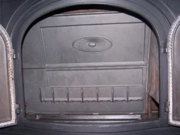

Hello Hearth.com. I suppose I should have come here the minute I bought my home. It was built in 1886 and the addition was built in 1945. We are not sure when the VC Defiant 1975 was purchased and installed. We have been here 2 years and the stove is spectacular. Well, that is until the 'inner liner' (firewall?) fell in on itself. There is a piece of this 'inner liner' that appears to support the right wall component of this 'inner liner' that has had a corner chipped off and I can not seem to put this 'puzzle' back together. I can't determine from the many diagrams/installation screenshots whether it is part #43 or part #46, or if I am completely off base. Here are some photos to assist anyone that may be able to help!

We have one of the early VC Defiants. It came with the one piece fireback which is the section that you see in your pictures with the decorative oval on it. When looking in the stove from the front doors the piece to the right of the opening is the baffle. The baffle supports the fireback. It looks like the baffle has a piece/leg missing at the bottom and has shifted downward. I don't recall how the original one piece fireback baffle was configured but the newer designed baffle has a 'leg' that bolts on to support it. WIth yours missing that and shifting down, this would cause the fireback to probably shift down and become loose. I wouldn't want to run a fire in it like that.
My father replaced the one piece fireback with the two piece kit in ours probably some 30 years ago or so due to a crack in it. I just finish replacing the fireback again as it developed a crack again. Lasted a good 30 years so no complaints. I don't remember what the one piece looked like but it may have been curved like yours is. The two piece in ours is more of a straight angled fireback. I have some pictures right after the rebuild.
I just quickly looked and I do believe you have the old fireback design. Others may correct me. If you fix this you will need the left end door and the new fireback kit. Here is what you would be looking at, something like this. Maybe $700 in parts counting the kit and left door.
(broken link removed)
The kit I just got was about $280 for the two piece fireback since ours was switched out long ago.
Good luck.
View attachment 190845 View attachment 190846 View attachment 190847
I may have been incorrect in my post prior to this one. I am not familiar with the later model Defiants. The one we have is one of the early models that had the one piece fireback. It may be that yours is a Defiant II. Again, I am not familiar with the other models.
This thread may be of help. Looks like a similar fireback to yours? https://www.hearth.com/talk/threads/defiant-ii-fireback-dislodged.160711/
