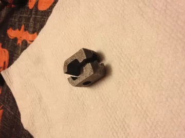

Install went great yesterday- very pleased with the aesthetics of the stove. However, during the install the cast piece on the door latch (small part the roller screws into) cracked! The installer said this was somewhat common, which I can imagine. Replacement part will be here this week until then I can't use the stove. Anyone else have the part break? Being a small cast piece, I was thinking of getting one machined out of solid steel so I would not need to worry about it.

Install went great yesterday- very pleased with the aesthetics of the stove. However, during the install the cast piece on the door latch (small part the roller screws into) cracked! The installer said this was somewhat common, which I can imagine. Replacement part will be here this week until then I can't use the stove. Anyone else have the part break? Being a small cast piece, I was thinking of getting one machined out of solid steel so I would not need to worry about it...View attachment 78449
I'm glad you like the look of the stove. I have no clue about breakage-my stove is being installed on Friday. I'll update that that time, but I'm sure you could have one made for minimal cost. Hopefully the part comes in for you and the replacement goes smoothly.
Somewhat common that a piece breaks? That's hardly acceptable.
