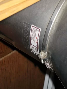

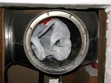

I have a friend with a Vermont Castings Aspen that vents 6 inches at rear. The piece that goes from the stove to the metalbestos class a pipe is only 6-8 inches long and is single wall.The metalbestos is 8 inch. So its a 6 inch at the stove going to 8 inch at the class a. This adapter should be a class a pipe. Also where it fits on the collar on the stove, it fits on the outside of the stove collar, which is wrong,it should go on the inside. Can someone steer me to a company that sells this please. The stove has been running for a year with the single wall, but for my piece of mind, I want to get the right class a adapter/increaser.
