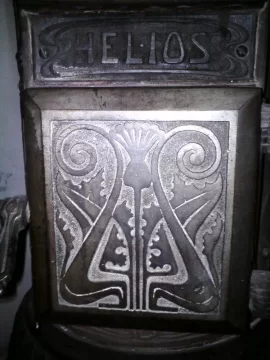

My Whitfield stove replaced a very old coal/wood stove from 1898. My family has had this old house for six generations. It was built in 1898 and this coal stove was the original that came with the house;) The coal stove is danish made by Kerteminde Jernstøberi model 'Helios'. It's still fully functional and It was in use until 2008, when it was replaced by the Whitfield.
The 'Helios' stove is now stored away on the loft, but I can anytime swap it with the Whitfield, if this proves to have too many 'bells and whistles'.
'No pics? or... it didn't happen' , so here are some pics of the old Kerteminde Helios stove from 1898. The style is typical 'Art Nouveau'
