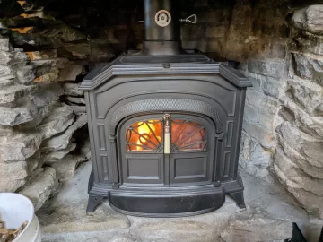

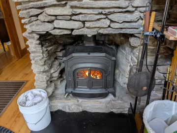

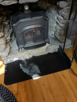

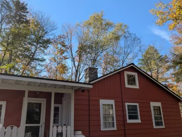

I owe a follow up. This project was delayed by a rotted sill and main carry beam on the camp that I worked on in 2024. I was determined to get it done this year. The top of the chimney is showing how I extended the pipe 18" before installing a wind/rain cap. The stove for sure is a 1985 Resolute and Graham The Stove Man said it was still in great shape but he cleaned, re-sealed and polished it on-site. I did add a Hearth Extender to protect the wood floor.

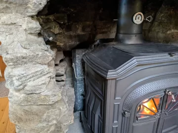

When I lit the first fire it went right out. I could tell it was starving for air. On the lower left corner there is a flapper air valve and I opened and it helped but the stove was still air starved. This model has a spring/chain/flapper valve on the upper left back. I reached around and the flapper was closed. So I turned the small wire handle attached to the flapper and chain and manually opened the flapper and the stove flame took off nicely. The spring is intact, the area is clean, the chain is intact and all looks OK but I guess I need to look into how the darn thing is supposed to work. I "think" it should already be open when cold and slowly close as the stove get hot.

6" SS pipe, insulated via kit, flue chase cover, extension and rain and wind cap. All purchased through Rockford Chimney Supply. I have less than $1450 in all the supplies. $350 for the stove cleaning, re-sealing and polish. A NH company quoted me $5500 and that didn't include the 18" extension or the wind/rain cap.
BTW, the stones are for looks. The chimney from the old damper up was built with cement blocks and then lined with a 12"X12" flue. I insulated the new liner and dropped it down through the flue.

It's a later model Resolute and a good little heater. We loved ours way back when though it was a Resolute I. The side flap is for secondary air. Leave it open. The stove is thermostatically controlled, but this could perform poorly due to the location. The thermostat responds to room temperature, but with it back in the fireplace cavity, it's going to get thrown off by the heat buildup there. If you can place a small fan on the hearth blowing into the back of the fireplace, that may help the thermostat and with heat circulation.
Are you engaging the bypass once the fire is burning well? Have you downloaded the manual for this stove (and all VC stoves of this vintage)?

Thank You. Once I pulled the stove out of the fireplace so Graham could work on it it was marked 1985 on the back. The serial # 075585. After reading your comment I "think" I understand why my late FIL added the damper to the exit pipe. Indeed the stove sits against the back wall of the old firebox. Perhaps he was having issues with the thermostat damper flap system and added one he could control by hand. I will do the same. The chimney was built in 1955/56. It wasn't until I pulled the stove out and looked up that I saw the cement block under structure. I'm actually happy that's the case. I haven't had a good bed of hot coals yet to close the bypass to throw heat. Graham said first couple fires keep it small and break it in from the new seals. I did down load the manuals so thanks for that. Not to be too cocky but I'm starting to feel like more of a wood stove veteran than a rookie! :)

You may need to open up the air control a bit when the bypass is first closed. Then as the firebox heats up, the air can be reduced. It's an easy to run stove and well-behaved once you get used to it. Just be sure to only feed it dry, fully seasoned wood.
