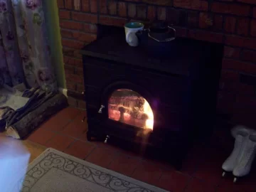

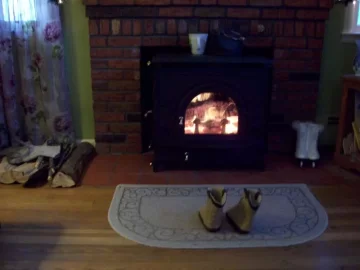

VCBurner said:Here are some pictures I took today of the Dutchwest hard at work! After a long hiatus, it once again gets a chance at making us happy and warm. I bought a Defiant Encore 2190 and was going to put it in place of the DW, but upon inspection of the cat in it decided to re-install the old beast (I'm going to keep both and put one downstairs and one upstairs.) We are glad to have it back in after a long needed overhaul of the chimney set up and clean up. This chimney had not been cleaned since we moved in (2007) but had not been used for wood stoves before 2009. It always looked clean but I found some gnarly stuff behind the old fireplace damper! There are pictures of the dirty fireplace, new pipe extension, new pipe whole on the block off plate and explanation of the overhaul in the venting set up in my other thread:
https://www.hearth.com/talk/threads/68912/
Now here are some pictures of the DW in action today!
VCBurner said:I knew you'd like the pics Ray! I was on cloud nine last night after a week without a stove burning in the house. That fire was the first one after a much needed upgrade and clean up. The cat continues to provide easy operation and burns up all the smoke on low choked down fires (unlike the one in the pictures! ;-) .) Actually I loaded the firebox after taking the pictures and didn't need to reload until almost noon the next day! (today) I cut some big uglies out in the left over pile, some oak v's that were impossible to split but were pretty dry and had been cut since 08/09 winter. They were under the tarp and were really tough to chain saw into manageable pieces. One of them was a v shaped fork with two 20" trunks that had been cut close to the crotch. It was a groan to cut, but burned really nice on low all night! I still have a 30" but about 36" long from the same tree. It has to be cut into manageable pieces too! I'll have to sharpen the chain before attempting to destroy that thing into burnable chunks. I'm glad I have the 2255 turbo, it would not have been possible in the same amount of time with a lesser saw! A piece of that oak tree is simmering in the fire right now! The air is shut almost all the way and small lazy flames emanating from it on top of a lightly glowing bed of coals, life is good!
