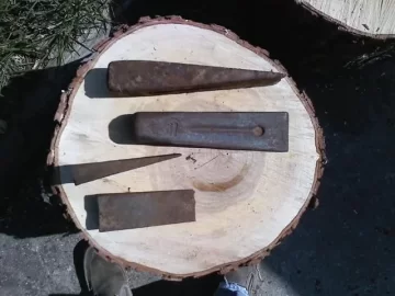

I have a few old wedges and some really stubborn rounds that my maul and little splitter can't break. The rounds have been just absorbing the wedge on the splitter and stopping and I've been doing a balancing act with the big rounds and chip away producing small splits (wasting wood).
I was thinking about using some wedges but have no idea how to use them. Any advice is appreciated.
This is what I have to work with

First those little ones are not much use splitting that tough round.
If the wood is swallowing the splitters wedge on the end,,,,
Do you have any sign of a split on a side?
That is where I would put a wedge.
If you can work a split down one side by leap frogging the wedges then go across an end.
Never drive a wedge in too far.
If it doesn't split it can be a real bugger getting the wedge out.
I have four of those bigger ones and sometimes it takes all four to split a knarly piece of Chinese Elm.
BTW, Have you tried standing the round up in your splitter?

Hareball, when asking about splitting a round you should tell us what you are trying to split as it would make it easier. However, without knowing what you have, my first inclination would be to take the smallest wedge and drive it in at least half way or maybe 3/4 (if you can use the bigger ones then use them instead). From there it would depend on what the log does.
Another thing you might do to start is to drive in 2 wedges, maybe 6" to a foot apart (again, I don't know what you have). Hit one wedge then the other to drive them down evenly. Sometimes the wood will try to split apart but not want to give. That is when I take two wedges and drive them in together....in the same spot. This can be tricky but it works nicely because it will force the wood apart further.
Another question is, should I try to split through the heart or more towards the side? Knowing what size the log is and the type of wood helps with this decision.

Dennis, I'm splitting some silver maple thats all twisted and about 16"- 20" across. After that I have some red pine about 20"-22" across.

I still would try splitting one from the side.
Insert first wedge near an end then drive it in and see if you get a crack to follow with your second wedge.
If you don't get a crack I would knock the wedge out and try a different spot.
It is easy to knock a wedge out IF it is near the end of the round.
