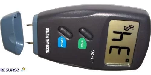

I just got one of those cheep moisture meters off eBay and tried it today. I split a log and found that I got very different readings if I lightly pressed the prongs in verses pushing them in as far as I could. What is the correct method?

Split a piece and jam it in 1/4 inch in the middle of the log. Thats your reading. Some take an average towards both ends and middle...
I read somewhere that you would get completely different readings if you took the reading with the grain vs. against the grain... not quite sure which is right.....
I'm guessin that it did not come with instructions?
I have the same meter. Gently push the prongs in as far as they will go. Most accurate reading is in the middle of a freshly split piece, prongs WITH the grain.

When you're going against the grain, you've got lots of wood cell walls to cross, and since you're basically reading the resistance to current flow, the resistance will be falsely high, making the meter say your wood is drier than it is.
When you are parallel to the grain, you are reading across far fewer wood cells walls, and so you will get a much more accurate reading.
It is key though to split the wood right before you take the reading, and to push the prongs in as far as they will go without too much effort. If they won't go in very far, pick another spot to test.
