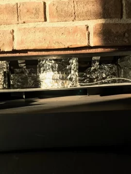

Initially installed the washer sensor on an uninsulated section of 6" flex liner above wb insert but below the block off plate.
I decided to insulate this short run of liner (about 9") and covered the sensor with the liner insulation (1/2 " foil face) used for the rest of the liner.
The temp readings between before and after differ by about 250-300 degrees. Old cruising temp was about 500-550 degrees and new temp is around 750-850 degrees. I do have surface mounted thermometers on face of the insert (PE Summit) and they read 550-650 degrees when cruising.
Does it make sense to remove the insulation around the sensor or leave it alone. The sensor is rated to 1650 degrees so I don't think it is getting too hot but would appreciate feedback.
