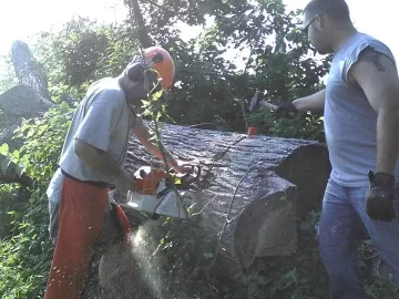

Was cutting a felled tree the other day. It was down on a hill and had a larger branch underneath it basically holding the base of the tree up. Started cutting and as I was going through the top started closing up on the chainsaw bar and basically got stuck. How would I use a wedge to avoid this from happening again?

  • Using a wedge!
